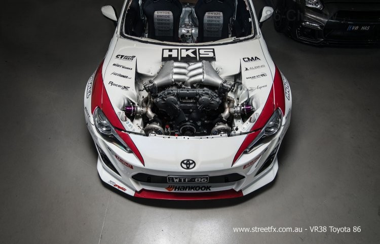

For several months we weren’t even sure this “idea” would be possible due to the sheer height of the engine, it was nearly three times as tall as the factory FA20 Boxer motor that Subaru threw in the engine bay.
VR38 (Nissan V6) on the left, FA20 (Subaru boxer 4 cylinder) on the right.
The only way we were going to make this work was make the V6 shorter.. MUCH shorter. So the guys at GT Auto Garage liaised with companies until we were able to track down a sump kit from Dailey Engineering in the USA that would convert the VR38 sump and front diff to a RWD only dry sump (doing away with the front diff completely). This cuts around 150mm (6 inches) from the height of the V6 engine.
The next challenge was sourcing a gearbox capable of being strapped to the back of the 4.1L HKS power source. We happened to be planning our VR38 build at the same time as the Motive DVD Erubisu VR38 R34 GTR, so Andrew Hawkins from Motive DVD hit up Albins Gearboxes for a 6 speed sequential for both of our projects.
If you haven’t hear of Albins, they are responsible for the gearboxes in every Australian V8 Supercar Race car. The power and torque specs of the box were higher than all of the other sequential boxes that we considered, putting this unit at the top of our “want” list. Thanks to Albins, they came to the party and made a custom bell-housing to suit the VR38.
Not being satisfied with a regular 6-speed sequential (personally finding the giant gear levers in the car distracting), we decided to hit up Motec and source an air-powered paddle shifter kit. This will give us super fast shifts and no ugly gear stick. The clutch pedal is still used for start/stop/reverse, but the ECU will rev match between gear up/down shift, so no clutch is needed once we are rolling.
Now that we had the key ingredients, the car, engine and box all went back to GT Auto Garage to actually get the engine and box fitted. Using the parts bins from other Nissans, Dave fabricated some engine mounts (using Nissan S15 Silvia parts), and modified the factory cross member. A new gearbox cross member was also required, as well as some cutting to the transmission tunnel to accommodate the much wider and taller gearbox. Surprisingly this gearbox is about half as long as the factory 6 speed manual Aisin unit that came stock in the Toyota and Subaru.
The guys from Direct Clutch have been very helpful and are building us a multi-plate clutch that will suit the sequential box and power requirements.
So, we test fit the engine and box with the new sump, and magically we still have a around an inch to clear the hood.
Dave from GT Auto is quite the handy man with the welder, and whipped up some pretty neat exhaust manifolds to accommodate the HKS turbos and wastegates, sitting them low and forward. The position of the turbos will give minimal lag, by having very short intercooler piping.
The engine in these pictures is actually a spare engine that we are using to test fit into the car while a fresh set of forged 4.1L HKS internals get installed into a brand new block at JHH Engineering. It was important to source a new block direct from Nissan, as these engines have a plasma coated bore, which means they can not be honed or machined internally. The HKS Stroker kit includes forged pistons, a new billet form forged crank with the extra stroke and forged rods. The standard bore of 95.5mm is retained, only the stroke is altered and increased to 95.5mm. The forged pistons are 80 grams lighter than the factory items.
The ultimate goal of this car is a combination of time attack (circuit), street use and roll racing. Not being built for one specific purpose will mean there are sacrifices for every category, but given the level of engineering and thought that has gone into this build, with a power goal exceeding 1000whp on Martini Racing E85 – it should comfortably be able to be used for a bit of everything.
The car will retain a full interior (albeit with a roll cage), stereo, dashboard, and we are even planning on retaining air conditioning (by use of an electric compressor from RenCool, since there is no room for a belt driven unit with the dry sump pump taking the place of the alternator).
